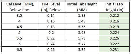

The measurements below are where I found my carburetors. These carbs were bench set with an 8mm float height. You can see that that static setting didn't produce consistent results for fuel level. You do see a trend, too; the lower tab heights result in lower fuel levels.
How do I know how much to bend it? Well, I had the same question. During this process, I took measurements and compared the fuel level with the tab height. Using some interpolation, I came up with a formula to determine how tab height impacts fuel level. Using that formula, I came up with the following guide. This guide provides the tab measurement based on desired fuel level. Measure each tab distance and use the guide as a reference to figure out how much to bend things to get the desired fuel level. For a target fuel level of 5mm below the line, the tab height should be somewhere near 0.224". Note that this is only a guide to help keep you in the ballpark. You will need to adjust the tab hight based on your actual measurements.
My desired fuel level was 5mm below line. I set each tab height to 0.224 inches. This actually worked and all four carburetors were at the appropriate level when rechecked. This may or may not be a reliable method.
