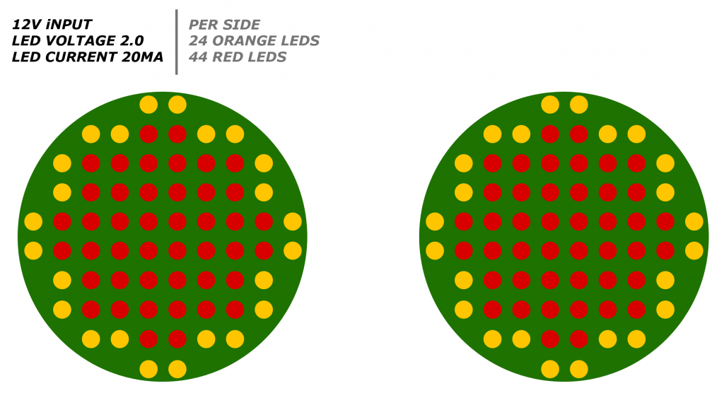

I'm going to change my tail lights back to LED this month but want to wire it myself this time so it fits better than the prewired stuff i used last time.
This is how i want the LEDs
I need help with wiring the LED's and resistors.
i think im right in saying as the LED's are 2.0v each i can only wire 6 in series which would be easy if they where in rows of 6 but as you can see there not.
The orange are going to be easy enough, its the red i'm struggling to come up with what order i will wire them in. any ideas would be greatly received.
