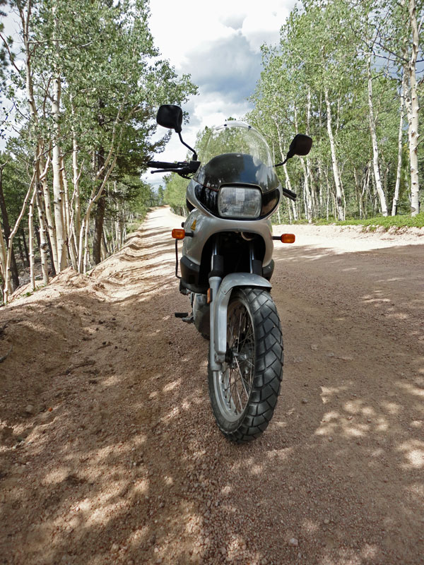

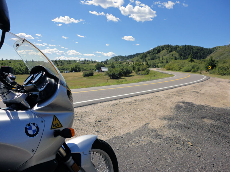

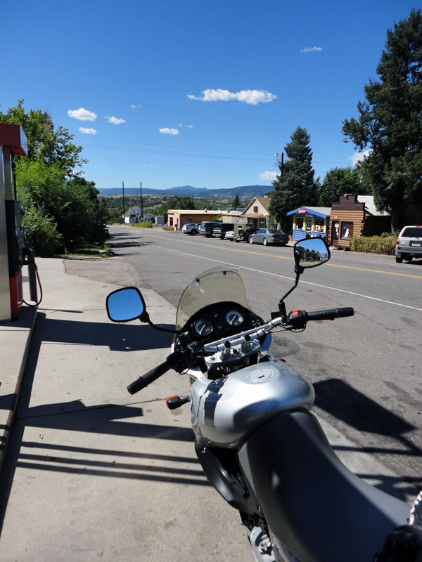

Its a bit low-brow but you can shape a piece of lexan and attach it to the top of the stock windscreen using a pair of well nuts. You'll have to drill your screen so theres no going back. I did this on my BMW F650 and it worked well:
Here's the only photos I could find showing the idea (I miss that BMW):
